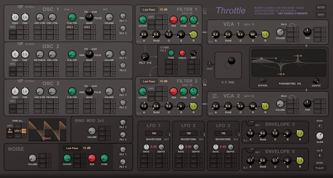

Martin - have you had a chance to look at my website to see if there's a GUI style (or combination thereof) you'd like for KS IV?
Back to the subject of the original post. I was so looking forward to including the Karplus in my emulation of the Radikal Accelerator, but ran into a complete brick wall when trying to complete this very old SM project with FS. It opens fine, and can work on it to some degree, but if I copy and paste anything, the program freezes; if I drag anything in from the toolbox, same thing. I finally gave up and am finishing it out with SM. Anyone care to try and see what may be the issue with this? Is it possible it's specific to my computer and/or install? Every other old SM project I've opened so far with FS has been no problem!
https://ln.sync.com/dl/f87583110/fkhzep ... g-ep7uyedb
Here's what this is looking like; almost done, but would love to include the Karplus.
The color scheme of the knobs is based on the slider colors on the Yamaha CS80; like tula, I have an aversion to over-flashy GUIs, but the Accelerator itself has the most boring-looking panel I've seen on a hardware synth! I sure wasn't gonna emulate that!

I can confirm it works fine on my PC (core i7, Windows 7 32 bit, FS 3.06, Sapphire Scarlett 6i6).
I tried several transfers from the toolbox, and copy-paste of internal modules, and no crashes or unusual behaviour.
I tried with DirectSound and ASIO prims.
The response to these changes was laggy, but that’s normal in my experience when a project gets big like this one.
I’ve occasionally found that it helps to turn off the ASIO/DirectSound, do your changes, Save As something, and then turn the audio back on. But I bet you tried that already.
You could also disable anything not required running in the background. I once had an issue where an antivirus update caused problems with ASIO.
Other than that I can’t think of anything else at the moment, sorry.
Good luck!

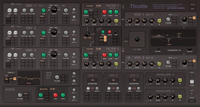

Well, your suggestion worked - after a fashion. I could do some work with it, but very, very laggy - funny, because I can zoom around in this thing at light speed with SM, no problem. Is FS not completely backward compatible with SM?
- Throttle copy.JPG (197.32 KiB) Viewed 22065 times

k brown wrote:Well, your suggestion worked - after a fashion. I could do some work with it, but very, very laggy - funny, because I can zoom around in this thing at light speed with SM, no problem. Is FS not completely backward compatible with SM?
I think it’s purely down to the amount of stuff in the schematic (especially it seems loads of bitmaps cause lagginess) and the speed of your PC. Also FS is far more capable than SM so probably has a bigger overhead. What’s your PC spec?
When I was building the SynthMaker Greatest Hits topic I found that if a schematic worked then I could do anything to it I wanted, with no crashes etc.
Of course not everything actually did work, so my guess is that it’s not fully compatible for whatever reason. But if it opens and functions it should be ok. It’s probably a good idea to replace prims marked as superseded though, to be on the safe side.
Is the reason you can’t incorporate the K-S system a technical one, or one of design; how to integrate it?
