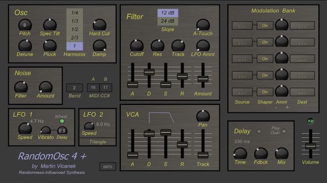

Given that, I did a version of randomOsc 4 with the same expanded features of what I called Randy +; Randy being Martin's chosen name for randomOsc 8.
My additions:
- Osc Pitch up or down 24 semitones.
- Second LFO using Martin's Multi LFO.
- Five-slot Modulation Buss.
- Wheel can be disconnected from Vibrato, for use with other destinations.
- Pitch Wheel generates three different, simultaneously available CVs - BiPolar, Up and Down.
- Dedicated Aftertouch sensitivity for Filter Cutoff.
- Two MIDI CC selectors that default to #16 and 17 for control by any MIDI joystick/XY pad that generates these messages (i.e.,Yamaha SY22, SY35 and TG33).

Still getting volume jumps in new version of Randy - while I await word from Martin about whether this might be specific to my machine (haven't heard from anyone else about whether they are experiencing the same thing), a few tweaks to RandomOsc 4 + (replaced in initial post).
- Pitch can can toggle from semitone-stepped to free-tune.
- A couple more options in the Mod Bank.
- A few presets of my own added.
- Fixed LFO 2 wave select not working.
