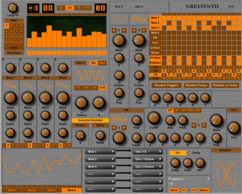

Hey Guys, here's a new toy. Its got a bit of "X11" theme to it.
A basic synth with some mods, routing matrix and automation matrix.
There's 8 presets, so all you have to do is hit the start button.
