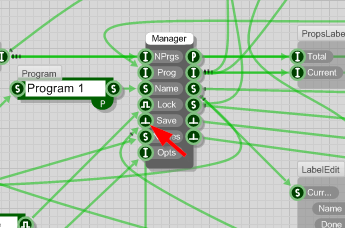

Postby Nubeat7 » Mon Feb 10, 2014 8:36 pm
billv wrote:Why....?????
When using VST , the user can just save into a Preset Manager slot.
wouldnt it be enough to just trigger the save input of the pm primitive?

Re: Preset Manager_Auto save/load.
Postby billv » Mon Feb 10, 2014 11:26 pm
No...that works in FS....but in VST/Standalone mode....nothing is there on plug-in reload.
Its always been like that :( . Very fustrating that the VST/standalone user can't use the
Preset manager just like we do in FS-save straight into slot..and it's there...
This VST/Standalone preset issue has led people(like me) to make "alternate" preset systems,
and you can see this in the last X11 Update, it's a very messy/ugly way to go about it. :lol:
I guess the file dialogs could be included, and bring back the option to save/load manually.
I'm still worried about the speed of it. And can only see 3 options to fix....
1. Stick all presets on 1 array and just load the one file on startup
2. Wrapping it all up into that dll componant thing might be possible....but I don't know C....
3. DSPR make a New Preset manager with option for autosaving.. :mrgreen:
