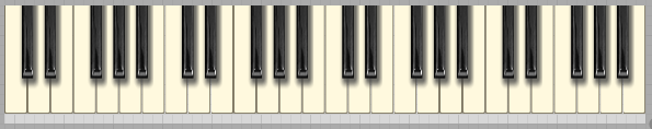

hi all,
here is a keyboard built with ruby,
i tried to comment the code with sense but some parts will be a bit confusing because it has 2 area containers one for black notes and one for white notes - it was the only way for me to make it work, maybe there are some better ways to built it up
its fully resizeable and also offers a latch mode where you can turn notes on with one click and off with a second click on the note.
v.04 : fixed out of range bug when dragging out of keyboard area
v.06 : last fix did just half of its job (4.3.15)
v.08 bmp: the bitmap version which uses images for the the keys

Nice work NuBeat, resizable too
I think the structure is fine, keeping the black and white keys separate makes sense to me.

Just to give some details of what djbrynte means.
The bug comes when the keyboard is being redraw while notes are playing and you open a drop down selector, it causes the audio to freeze and loop. This is Flowstones thread protection working and look like only way to avoid such a situation is to not redraw the notes with incoming midi.

thank you exo. I dont know mybe its working some way. I hope some one have a smart idea for this. Because if flowstone have a working keyboard will be +.

Has anyone already tried Ruby's Thread.new in this context?Exo wrote:This is Flowstones thread protection working and look like only way to avoid such a situation is to not redraw the notes with incoming midi.
