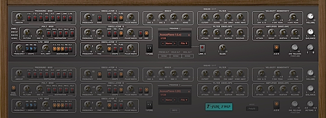

So, without the split keyboard option here's T-forTwo.
T-forTwo copy.jpg (79.45 KiB) Viewed 19442 times
The Prophet T8 was essentially two Prophet 5s (with polyphony of each reduced to 4) with extensive velocity and aftertouch controls, and an excellent weighted piano-style keyboard. The two 4-voice engines could be played singly, with keyboard splits or layered together. The two were sent to separate left and right outputs, or a summed mono out. So the plugin represents two complete synths, each with their own preset manager so any combination of two presets can be used - layered together in mono or panned in stereo.
I tried to make this as accurate as possible and the only major 'upgrade' is the addition of a third oscillator in each.
Twenty presets (mostly from the T8 factory preset patch sheets) are included in each 'Voice'; several are in pairs (suffixed 'I' and 'II') and meant to be played together in layers or splits.
If anyone cares to take a shot at getting this to have the keyboard split option, that would be great to have that feature, but I'm bald as a cue ball tearing my hair out over it. Utter defeat.

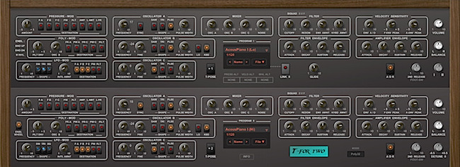

When the I/II balance control is fully CW or CCW, the unused 'Voice' is muted, cutting CPU in half, and it's panel is darkened to make the GUI less overwhelming and with less eye-strain.
