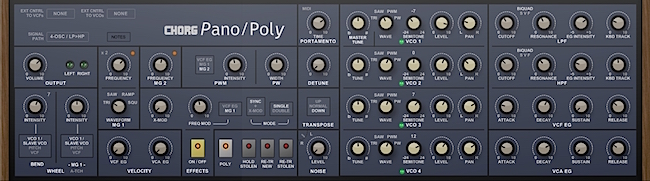

We got here an arpeggiator-free emulation of the Korg Mono/Poly, but in full stereo and LP > HP series filters. Also has signal path that can switch from the emulative structure 4-VCOs into VCF (here LP>HP), to 2-pairs of VCOs into two LPFs. Each of the four VCOs plus the Noise can be panned anywhere in the stereo field, so I'm calling it Pano/Poly.
Aside from it's odd paraphony and arpeggiator functions, the real star of the show (IMHO) with the Mono/Poly was the powerful use of it's four VCOs in various combinations of Sync and Cross-mod:
- Sync, where VCOs 2-4 sync to VCO 1 ('Single' mode).
- Sync, where VCO 2 syncs to VCO 1, and VCO 3 syncs to VCO 4 ('Double' mode).
- X-Mod, where VCO 1 cross-mods VCOs 2-4 ('Single' mode).
- X-Mod, where VCO 1 cross-mods VCO 2, and VCO 3 cross-mods VCO 4 ('Double' mode).
- Sync plus X-Mod ... Single mode.
- Sync plus X-Mod ... Double mode.
Wheww ! All this without the complexity of modular patching. Plus these crazy modulations can be turned on and off with the touch of the oddly-named 'Effects' button.
It also had some clever switching for the P-Bend and Mod wheels to make maximum advantage of the Sync modes.
Chorg PanoPoly copy.JPG (140.26 KiB) Viewed 24503 times
Loaded with over 20 presets, mostly rough stabs at those from the Mono/Poly patch book.
Early Korg synths were noted for their LP > HP series filters (similar to Yamaha's CS-series synths, but in reverse order), so I added a 2-pole HP in series with the 4-pole LPF. The HPF is switched to a second LPF when in '2-pairs into 2-filters mode'.
In the panel space where the Mono/Poly had it's arpeggiator switches, I've put VCF and VCA Velocity controls (the M/P did not have velocity). I've also added a couple of functions that are popular mods/hacks to the hardware (double speed LFO, aftertouch control of mod wheel depth, VCO 4 as option for mod wheel source). Various hardware MIDI controllers can be applied to the VCF and/or VCA (like M/P's rear panel jacks).
There are multiple software emulations of the M/P out there (Full Bucket's is much better-looking than Korg's own, which is cluttered and in-authentic), but none of them has dual filters and per-osc panning (unless Korg's has these as menu-hidden functions, I don't know).
Currently under re-construction.

Since I personally don't care for staring at a lot blue for a long time, I've made the BG color changeable to that of the chocolatey brown of Native Instruments' FM7 (the new white GUI for FM8 is hideous) or the deep, warm taupe of u-he's Bazille.
Also, I forgot to ask in my OP, since this relies so much on sync, why have Martin's oscillators never had sync inputs?
