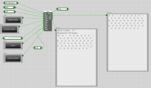

I try to get UDP Messages from a UDP server.
It should work, when I look with a other UDP monitor I see the UDP server sends the requested data.
But with the udp.fsm program I receive only the transmitted data.
Is ther somebody with a good suggestion what I have missed?
I have read Component Reference.pdf page 316 And is so clear that its almost impossible to make a mistake

I know what the problem was, my incorrect handling of the fs client port number.
My microcontroller server now looks to the port flowstone has choose.
