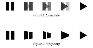

Whats the advantage of this over using standard crossfade between generated waveforms?

The best example of the difference between true morph and crossfade is Saw to Tri; there have been a couple of true morphs done (Spogg did one) - when one of these is put halfway between Saw and Tri, a beautiful, rich timbre results that is impossible to achieve by crossfading Saw and Tri.
Re: Morph 3 waveforms
Morphing between classical waveforms has a flavor of PWM.adamszabo wrote:Whats the advantage of this over using standard crossfade between generated waveforms?
Hello Gang,
Here is an example of Morph versus Crossfade. Now my Saw wave is not perfect and you do not get all the particles, but if you play with the knobs you will see the differences.
Ok gang, I hope I am not the only one here to post one, lets see some more Morphs!
Later then, BobF.....
