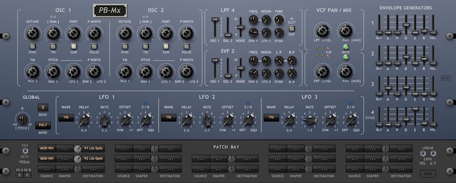

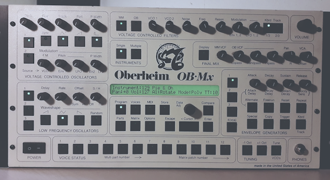

This one's based on the rather obscure Oberheim OB-Mx, which came out after Tom had left the company and was actually a project begun by a team that had a lot of trouble, so Don Buchla (of all people) was brought in to bring it to completion.
https://electronicmusic.fandom.com/wiki/OB-Mx
49
PB-Mx copy.jpg (159.54 KiB) Viewed 12626 times
PB-Mx.fsm
(7.57 MiB) Downloaded 1017 times
- Two wave-mixing oscs, with separate Portamento. Each can phase modulate the other.
- Two Filters - a 4-pole LP and a 2-pole Multimode; each with it's own input mixer.
- Two pannable amps.
- Three LFOs
- Four DAHDSR EGs.
- 14-slot Mod Matrix.
The hardware was a real headache to program; the panel only had a single set of controls for most of the sections, so you could only adjust one osc at a time, one LFO at a time and one EG at a time. Here, of course, all is visible and accessible at once.
This represents one of it's 'voices', so is not 'multitimbral' like the hardware.
Personally, I thought the OB-Mx's interface was a real snoozer (except for that great logo),
so it made a great candidate for 'the Pultec treatment'. The blue panel can be switched to red.
The OB's Mod Matrix is represented as a Patch Bay.
Be sure to read the info pane on the LFOs - they have some unusual controls and capabilities that show the unmistakable hand of Buchla.

Great, thanks! ;) :D
It took me a little time to find the preset manager, maybe one line thicker would make it more obvious, no drama... ;)

Postby k brown » Tue Apr 28, 2020 11:05 pm
Replaced schem in original post - fixed incorrect connection in SVF BP output.
:oops:
Updated 5/13 - should use slightly less CPU now.
