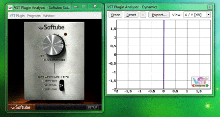

Postby DigiTonix » Wed May 18, 2016 12:47 pm
Hi ... I analising Softube saturation knob ,,, got here such evidence ... quite interesting, it will be necessary to work with the assembler that it would happen ... probably
