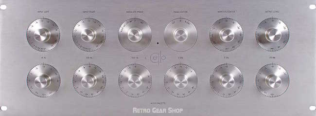

In the mid '80s (at the peak of my life as an audiophile) Mark Levinson started a new company called Cello. It's flagship product was a high-end and extremely expensive equalizer, of all things - something shunned by the entire audiophile community. But designed by someone who knows what they're doing and using the very best circuit components and construction methods, even the tweakiest critics had to admit that it made a huge percentage of commercial recordings much more pleasant to listen to. The Cello Audio Palette was not for room or system correction; it assumed a well-balanced system to start with - it was strictly intended for correcting poorly-balanced source material. It even became used by many professional mastering engineers as the final 'sweetening', or correcting older material for re-issue.
http://www.celloseattle.com/ctdocs/prod ... lette.html
We can, of course approximate such a device with FS, and I was very surprised to see that there is essentially no plug-in based on it! (EDIT: I finally found one - https://www.danielhertz.com/master-class-software - Mac only) One can set up a software 6-band parametric to do the job and save the settings as a preset, but I wanted a plug-and-play dedicated Cello-like EQ. Plus, the toolbox parametric is very difficult to adjust without shifting the frequency points. I'm sure someone could figure out how to adapt the graphic EQ that Spogg has used lately, but I sure wasn't able to. But even my clumsy attempt using the Martin-corrected SVF, the results were very effective. I was quite surprised that even listening with HiRes headphones, I could couldn't hear any difference with the circuit switched in and out, with all the controls flat.
Listening to a number of my own live (mostly classical) recordings, I've yet to come across one that wasn't considerably improved by this. An interesting aspect of the Audio Palette's design was that the top and bottom bands are not shelves, but are peaking EQs set to above and below human hearing (25kHz and 15 Hz). So one is hearing only the 'shoulders' of these bands as they 'slope' into hearing range. The 'Blend' position of the Equalization switch blends the stereo channels together below 40 Hz. Can often 'tighten' the bass on certain recordings.

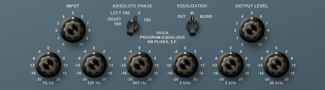

Not being terribly imaginative, and unable to replicate the Cello's knobs and panel, I did this up in my 'Pultec' style.
I'm wondering if the ZDF multimode would be a better choice for this. I imagine Martin could probably do the whole thing up in a single chunk of code!

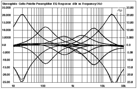

For those wanting to correct or improve my take on it, here are the specs for the Audio Palette.
One forum post lists the Q's as such:
Another claims they are all 0.7. Unfortunately, none of the published Cello documents specifies what they were.
As you can see the boost/cut at the center two fr are only 6dB, and all the Qs are quite mild. As you can also see, the first specs I show are incorrect as regards the top fr - it's 25kHz, not 20. This is verified by the panel legending, which states '25 kHz'.
Someone with experience reading such measurements could probably deduce the Qs from this chart.
All the controls were stepped - they were actually ladders of fixed resistors, not pots. The fr controls each had 24 steps.

It is quite straightforward to extract the Q values from the curves. If f0 is the center frequency, then determine the frequencies f1 and f2 to the left and right of f0 where the transfer curve attains half the peak (or dip) height in dB. Then Q = f0/(f2 - f1).
Example: for the trebble boost curve f0 is 20 kHz and the peak height is 20 dB. The curve goes through 10 dB at f1 = 7.5 kHz and f2 = 50 kHz. Hence Q = 20/(50 - 7.5) = 0.47.
A quick estimate indicates that all Qs in the graph
are around 0.5.
If you build this thing in digital make sure to use some sort of matched peaking filters (not plain RBJ) at least for the trebble control.
are around 0.5.

Here is an emulation of the EQ part, according to the transfer curves in the first post. Kevin, please check thre transfer function of your Viola, I believe there is an issue with negative dB settings (cuts).

From the transfer curves, the top frequency would seem to be 20 kHz for boost, however 25 kHz for cut. The peaking filter matching scheme only works for center frequencies within the Nyquist range, which is < 22.05 kHz for a sampling rate 44.1 k. Therefore, II would leave it a 20 kHz.
BTW you can do the matching for any filter topology (direct forms, etc.). I recommend ZDF for its superior performance truncation error wise at low frequencies (where matching is actually less imposrtant).
