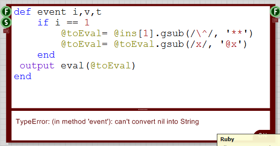

ruby error.png (20.45 KiB) Viewed 17180 times
I'm getting this error.
I don't know what I'm doing,
I haven't learned waveshaping
nix
Posts: 817
Re: 5 code lines polynomial waweshapr (green)
Postby trogluddite » Sat Nov 17, 2012 1:54 pm
Looks like t's telling you that you haven't give the variable @x a value yet. Undeclared variables always return nil.
What is probably happening is that when you retype code, the whole primitive is parsed again, and this sometimes clears the values in the input variables. Ruby primitives don't "request" values from upstream modules like green does, you have to push a value in from outside, so after an edit you sometimes need to refresh the input values by triggering them. This also means that input values don't default to zero like they do in green - if you haven't triggered an input yet, it will always show nil - this is catching me out all the time too.
Best thing to do is to put a test in the code, e.g.
Code: Select all
if @x
  #do some stuff with @x#
else
  raise "@x is not set yet in MyMethod"
The raise command send an error message to the console - using this inside your method definitions will make bug tracing 100% easier.
trogluddite
Posts: 1730
Location: Yorkshire, UK
Postby unkargherth » Sun Nov 18, 2012 7:14 pm
OK. my mistake. Seems to be solved if the line reading
Code: Select all
output eval(@toEval)
is changed to
Code: Select all
output eval(@toEval) if (@toEval && @x)
