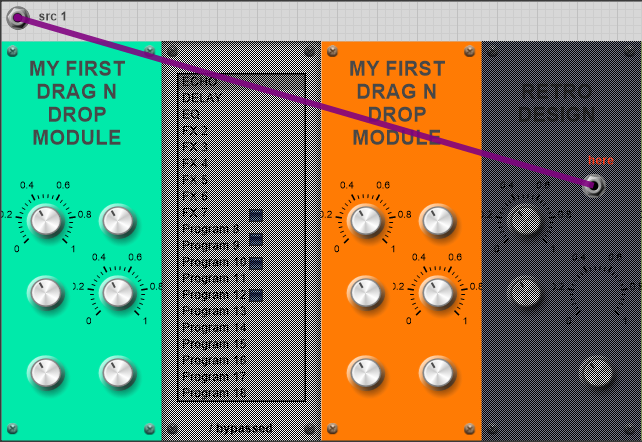

OK so I found drag n drop fx schematic whitch was very old and only vertical. I rebuild it to horizontal and fixed H and W. I dont know who s author but big big thank for that. So its behaving noW like eurorack modules you only click and move to change the order. I ts a fast mash-up... lots of detail tunning needed. It also have bug in x64 version: no ruby knobs turning, only SM-FS like.

- Added background: modular-a-like doom case
- If you move the grey module its 2D XY now!
see:
- shadows added on moving
if you wanna fix all the gui "dontfitism brokenstyle" then lets go.
https://gofile.io/d/zUJ6S6

- fixed positions in X, bugging in Y
- shadows now fiting the module
- srews will unmount on mouse move "unmounting from rack effect"
Drop _2.1ACKGR XY Screws.fsm
https://gofile.io/d/XxfTF2
Probably happiest time with Flowstone i ever had

It gets even better! Excellent! with the handles, everything was fine, as you said. Only the green module, when dragged, does not behave like everyone else. All modules can be moved in any direction when dragging. Green only some middle position (to the side and up at the same time)

it is ok now - only a few gui issues still
- number of modules - now six
- bypass on movig mouse Ldown under the bottom line
- Menu for selecting the whatever schematic with gui size 160 x 400, now from 18x list NOT PLUGED YET its taken from Ernst preset manager for future slider... if over gui
- menu/bypass state is movible as others
- whole "physics" got the logic now via shadows reaction on behaviour of user
https://gofile.io/d/4j6hKe

Hi, if you mean with friezes freeze-like-effect then put the redraw module with ticker100 in: Effects Chainer / M OViG MODUle / RACK and plug it with that bitmap. The major of this, is gone. The rest is not so disturbing while dragging to me - only happens in fast moves

tip-top GUI dragging here need other mouse module with value changes ticker that will make more frames "fps"

One cable was successfully implemented in the rack
