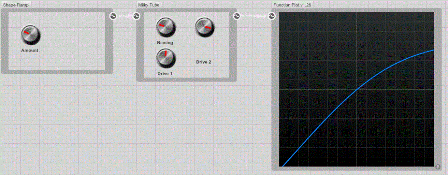

Hello Gang!
After a long binge :D ... I decided to start working again with distortion, this is my algorithm that gave good results, maybe you will help something to improve!
Milky Tube v1.fsm
(15.72 KiB) Downloaded 1124 times

Postby Logado » Tue May 23, 2017 5:22 pm
Interestingly, I also work right now with a distortion. But I can not automatically restore the volume.

Postby BobF » Tue May 23, 2017 7:42 pm
Hi Logado,
Very nice creation, I really like the sound, very nice distortion,. Great with guitar, bass, and synth.
Keep up the great work!
Later then, BobF.....

Postby DigiTonix » Wed May 24, 2017 9:41 am
Thanks guys !, maybe I can make an optimized version, and also plan to make a nice interface and some changes . ;)

Postby martinvicanek » Wed May 24, 2017 8:17 pm
DigiTonix,
if you want to take this further I would recommend adding some pre and post distortion filtering options.
