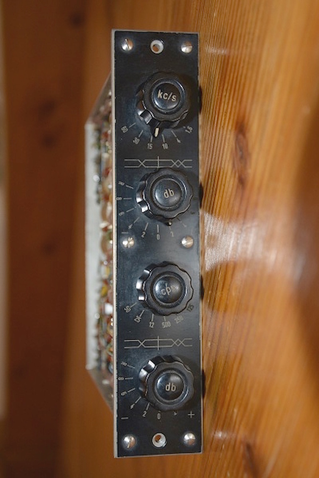

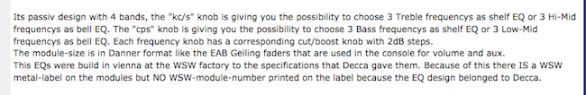

Gonna try to approximate this very cool EQ used by Decca in the Sofiensaal from Gotterdammerung on:

No, not curved text, but text on a knob that rotates with the knob (see pic).

Text rotation is not part of GDI+ and therefore not available in Flowstone. You could painfully draw the text into a bitmap and rotate that one with the knob, but that would be way to much work for this small effect.
Instead build a graphic containg the text for rotation and rotate it in Knobman.
