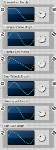

Hi gang,
here is a little excersise on morphing wave forms.
Note that morphing is different from simple crossfading.
The tricky thing is to get rid of (most of the) aliasing introduced by the waveform discontinuities. Here I used a technique called (first order) DPW.
The schematic contains six oscillators each of which allows morphing between two of four waveforms (sine, triangle, square, and sawtooth). If you just want the bare osc without the wave display you can go inside and grab the corresponding module. The morph input is poly type hence can be used for modulation.
Have fun!
morph.fsm
fixed frequency hopping
(54.38 KiB) Downloaded 1141 times

Very nice! Although when I add a frequency control for the osc pitch, even with a dezipper they seem to jump instead of going smooth. Maybe I am doing something wrong?

Thanks for spotting the bug, Adam! :oops: Now fixed and replaced in the original post.
FlowStoner wrote:DPW is not famous for intesive modulation stability. :o
True, especially for higher orders. I chose first order as a compromise between (hopefully) acceptable alias suppression and modulation capability. If in doubt, try it out for your specific use case! ;)
