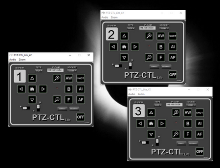

IDVIEW simply a memory aid to display the camera number in which you are working, in case of opening
several instances of the controller.
Comment and ask any questions you have, and if possible I will answer them.

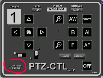

Light update v 2.1 only with the addition of a JoyStick control, in my case PS4, originally the Flowstone primitive is for PS2, so we will have a variation of the order of the buttons
Layout
L3:
H = PAN LEFT/RIGHT
V = TILT UP/DOWN
PUSH = HOME
R3:
V = ZOOM IN/OUT
PUSH = SHOT WHITE BALANCE
TRIANGLE = BARS On/Off
CROSS = AUTOWHITE On/Off
RECTANGLE = AUTOIRIS On/Off
CIRCLE = AUTOFOCUS On/Off
The status Led "JOYSTICK ENABLE" turn on only if it is connected before running the app
Layout
L3:
H = PAN LEFT/RIGHT
V = TILT UP/DOWN
PUSH = HOME
R3:
V = ZOOM IN/OUT

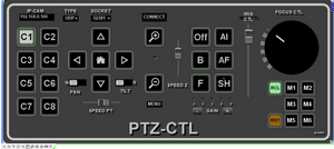

- capture2.png (41.52 KiB) Viewed 75455 times

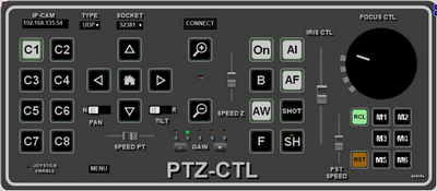

Here's PTZ-Full with the known limitations regarding updates to the selected camera,
but with more control features. I hope you find it helpful.

- PTZ Full400.png (52.67 KiB) Viewed 62850 times
