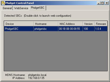

3) Open the Phidgets Control panel and click on the SBC tab:
Check that the SBC is found on your network?

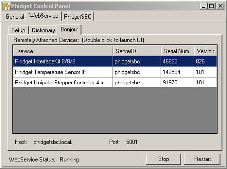

4) Click on the WebService Tab: Then the Bonjour Tab
Check that you Phidgets have been found and that the WebService is RUNNING!
5) Note down the Server ID and the Serial numbers of your Phidget Devices.

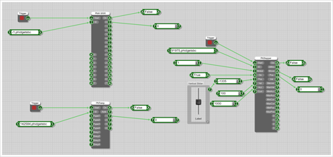

6) Open the new FlowStone V1.1.5
7) Drag in your Phidget devices
8) Add the correct Server ID and Serial numbers for the Phidgets:
9) Send a Trigger Start to each module and check that the Phidget is ON using a Bool on the On output.
