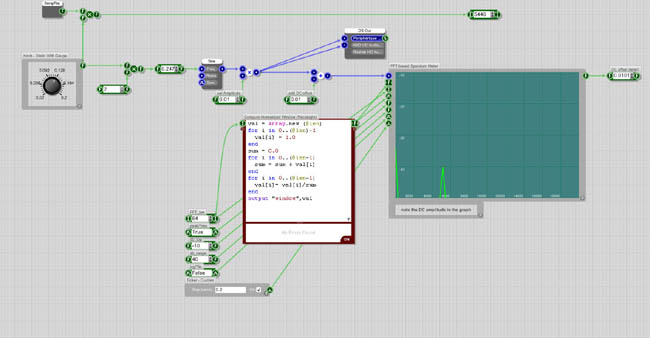

@ MyCo : thanks for pointing this. I have refined the .fsm, including a DC offset management :
- add some DC offset to the signal
- detect the DC offset within the Spectrum Meter (before any windowing)
- carefully observe the DC offset height now showing on the graph : it has a +6dB error
- apply a frequency that's very close to Fs/2 and observe the magnitude on the graph : it has a +6dB error
See the attached .fsm.
It is going to trigger an interesting discussion.
from http://www.dspguide.com/ch8/5.htm
by Stephen W. Smith : "As shown in the figure, the bandwidth can be defined by drawing dividing lines between the samples. For instance, sample number 5 occurs in the band between 4.5 and 5.5; sample number 6 occurs in the band between 5.5 and 6.5, etc. Expressed as a fraction of the total bandwidth, the bandwidth of each sample is 2/N. An exception to this is the samples on each end, which have one-half of this bandwidth. This accounts for the scaling factor between the sinusoidal amplitudes and frequency domain, as well as the additional factor of two needed for the first and last samples.
Many authors do not even include the 2/N scaling factor. Be prepared to find both of these missing in some discussions. They are included here for a tremendously important reason: The most efficient way to calculate the DFT is through the Fast Fourier Transform (FFT) algorithm, presented in Chapter 12. The FFT generates a frequency domain defined according to Eq. 8-2 and 8-3. If you start messing with these normalization factors, your programs containing the FFT are not going to work as expected."
Is Flowstone FFT + MagPhas obeying the standard, regarding the first and last frequency bin magnitudes?
What standard, actually?
Is is recommended to keep the first and last frequency bins "as is" from the FFT algorithm?
Is is recommended to include a correction factor on the first and last frequency bins, in the FFT algorithm, for streamlining the curve plot?
Is there a difference between GraphFF (method 1) and FFT + MagPhas (Method 2)?
What are the choices made by Synthmaker/Flowstone, and why?
