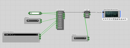

a right i think i get you! you want multiple IR waves to be stored and a way of retrieving them? you can do that by populating a wave array!
here i have set up a ten wave array to demonstrate what i mean! to populate the array you just load a file into each index and then use mem get to retrieve the wave at a given index! just remember that arrays start from 0.
i.e 0,1,2,3,4,5.......
here is an example
array.fsm
(53.37 KiB) Downloaded 1494 times
hope that helps!

Postby Jay » Thu Jan 23, 2014 10:42 am
Hiya wishx
here ya go ive added a wave array to the IR Filter, inside you will find a little widget for populating the array with your chosen wav files, see the video on how to use it. you can delete the widget once your files are all loaded and you are happy, the files will be stored in the array.
http://www.youtube.com/watch?v=JGactBeY ... e=youtu.be
IR array.fsm
(139.36 KiB) Downloaded 1433 times
hope that helps
