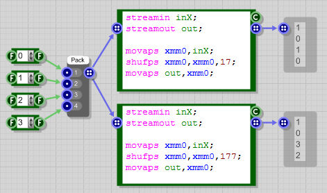

KG_is_back wrote:It treats mono4 as two stereo pairs (0-1 and 2-3)
In that case, should the third parameter of the shufps instruction not be 177 rather than 17?
Re: Stereo Limiter
Postby KG_is_back » Mon Jan 20, 2014 10:09 pm
Yes :oops: you are right. A stupid mistake I've made.
