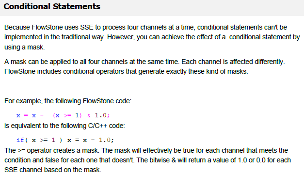

It is always a good idea to consult the User Guide first, so let me start with that:
Let's elaborate a bit. There is the & operator, a "bitwise and" for the arguments left and right of it. In the example given, one argument is a boolean expression (x >= 1) and the other is a float number 1.0. Both have a 32 bit representation in FS per SSE channel. The boolean expression is either true or false:
