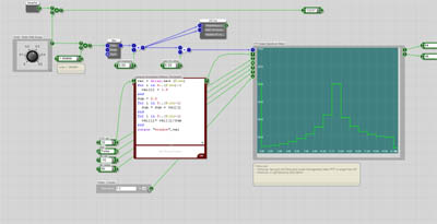

Can somebody check if this Spectrum Meter can be considered as accurate?
See attached .jpg and .fsm
Considering a FFT computed on N time-domain samples, the FFT delivers (N/2)-1 spectral bands.
Any decent computer should be able to run any FFT size up to 256, with a ticker equal to 0.2 second.
The frequency scale only gets readable for FFT sizes equal to 32 or less (16, or 8, or 4).
The frequency scale represents the start-stop frequencies of all spectral bands.
The first spectral band is the one starting with DC - that particular one has a bandwidth equal to Fs/(2*N).
The next spectral band exhibit a frequency bandwidth equal to Fs/N.
The last spectral band is the one ending at Fs/2 - that particular one has a bandwidth equal to Fs/(2*N).
Let exercise, configuring an FFT size equal to 32, and a signal amplitude set to 0.1 which corresponds to -20dB in a system where the reference signal has an amplitude equal to 1, thus evolving between -1.0 and +1.0 in the time domain.
When adding DC to the signal, the level displayed by the first spectral band is stable, and corresponds to the level you would expect. Say you add 0.1 as DC to the input signal (supposed to go from -1 to +1). On this Spectrum Meter, the first spectral band will display a -20 dB level. Surely this is correct ...
When the signal is a sinus at a frequency that's very close to Fs/2, the level displayed by the last spectral band is unstable. There appear to be a beat phenomenon. Say the signal is 22,049.5 kHz at a -20dB level. On this Spectrum Meter, the last spectral band will be pulsating at a 0.5 Hz rhythm, displaying a slowly variable level sitting anywhere between -20dB and nihil. Is this correct ?
When the signal is a 8.268 kHz sinus (set the knob a tad bit below the 0.2 value) at a -20dB amplitude, the Spectrum Meter displays a nice clean spectrum. Only the 7th spectral band appears to be active. It displays a -20dB level, as one would expect.
When the signal is a 8.985 kHz sinus (set the knob a tad bit above the 0.2 value) at a -20dB amplitude, the Spectrum Meter displays a wide spectrum. All spectral bands appears to be active. The 7th and 8th spectral bands appear to be the most actives, and fluctuating. They fluctuate anywhere between -23dB and a -25dB. Reading such spectrum, nothing tells you that the input signal is an ultra-stable -20dB sinus signal at 8.985 kHz. The Spectrum Meter seems to be malfunctioning. The bad guy is the short FFT length. This is a mathematic thing. One must remember that a FFT_32 behaves like it is analyzing a signal of infinite duration, made of chunks of 32 samples repeating indefinitely. Because of the chunks appending to each other, there is a discontinuity at the boundaries in case the 32 samples chunk has a duration that's not a multiple of the sinus test signal period. Each boundary discontinuity introduces a Dirac pulse into the infinite length signal. The longer the FFT, the bigger the dilution. With a FFT_32, you introduce a Dirac every 32 samples. With a FFT_256, you only introduce a Dirac every 256 samples. Changing the FFT length to 256 restores selectivity and stability.
Let's revert to a FFT_32, and a 8.985 kHz sinus (set the knob a tad bit above the 0.2 value) at a -20dB amplitude. We are not yet finished with it. As seen previously, the Spectrum Meter displays a wide spectrum. All spectral bands appears to be active. The 7th and 8th spectral bands appear to be the most actives, and fluctuating. From there, both sides of the spectrum appear to decay smoothly. There is a clear pattern. Without changing anything into the setup, let's observe the behavior of the first spectral band (the one towards DC) and the last spectral band (the one towards Fs/2). Both don't fit the smooth decay pattern. They would better fit the smooth decay pattern, if they were 6dB up. Is this normal ?
At this point, there appears to be a contradiction.
1) The first spectral band appears to deliver the expected level in dB, compliant with the amount of DC we introduce into the measured signal. Indeed, adding 0.1 as DC, to a sinus signal fluctuating between -0.1 and +0.1 delivers a spectrum having the first spectral band at -20 dB, and the spectral band corresponding to the frequency of the sinus, also to -20 dB. We thus assume that the first spectral band got correctly calibrated.
2) We attempt doing the same calibration for the last spectral band, but unfortunately no firm calibration is possible because when supplying the -20dB "close to Fs/2" signal that's needed, we face a beat phenomenon. All we can see, is the last spectral band fluctuating between the -20dB level (the one we are expecting), and nihil. We thus assume that the last spectral band got correctly calibrated.
3) Doing so we have the impression that we have done everything right, for calibrating the Spectrum Meter. However, when supplying a 8.985 kHz sinus signal (not fitting the sampling window), we observe that the first spectral band and the last spectral band are 6dB down the ideal level that would ensure a smooth decay of the spectrum. Such is the apparent contradiction.
I think there is no contradiction at all. When harvesting noise, like the boundary discontinuity is, the first spectral band and the last spectral band appear to be 6dB down the expected levels, because they harvest half the frequency bandwidth of all other spectral bands.
I think that my Spectrum Meter is correct, and correctly calibrated.
For achieving this I needed to apply a bug fix, the one I'm calling FFTmagbugfix.
Within FFTmagbugfix, I process the Float Array delivered by the Synthmaker/Flowstone built-in FFT and MagPhase components. I divide by 2 the magnitude of the first spectral band, and I divide by 2 the magnitude of the last spectral band. I think that such bug fix is needed for achieving a correct Spectrum Meter calibration.
If the bug is confirmed, its origin is easy to understand.
Apparently, somebody within Synthmaker/Flowstone staff, realized there was a 6dB drop at the edges when dealing with certain signals, like the 8.985 kHz sinus. For restoring a smooth decay at the edges, he added 6dB to the first and last spectral bands. It becomes clear why most people relying on such buggy FFT, say that it delivers wrong results in presence of DC. Surely it delivers a wrong result in the presence of DC, as it overestimates the DC by 6dB.
Am I right?

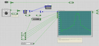

Just added flexible windowing.

Re: Weird built-in GraphFF Magnitude scaling
dB grid is now automatically managed, using the dB_range parameter
see attached .fsm
see attached .fsm
FFT-based Spectrum Meter (flexible windowing)(FFTmagbugfix)(Lines).fsm- (19.11 KiB) Downloaded 1398 times
- steph_tsf
- Posts: 249
Looks ok to me. The fix seems to work, although I don't know why this is needed. Believe me, the devs done nothing to the FFT code. I think they use a straight forward implementation, like we do for the stream fft. There is no workaround in it. You can compare the FS FFT output with one of the free calculators on the internet, and they'll output exactly the same.
