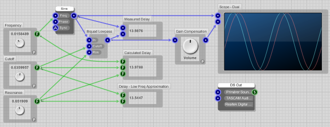

Here is a little test setup for delay estimation. A sine wave is fed into a biquad lowpass filter and compared against the original. The resulting delay can be measured by evaluating zero crossings. As you see, it may well exceed 2 samples.
I have also included a calculated delay from the real and imaginary parts of the transfer function. This may be a bit CPU intensive, so I have also thrown in a (much cheaper) low frequency approximation (which may or may not be sufficient).
I'll try to apply this to your (Nubeat7) schematic tomorrow. I see you have both a lowpass and a highpass in the feedback loop, so that's something to consider.
