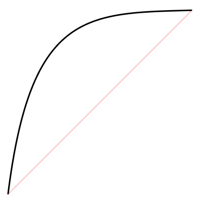

I've done the tests!
Here's what my dream envelope generator module would be like:
- The attack phase switchable between linear and logarithmic (I want to offer the user the possibility to switch)
- The decay phase switchable between linear and exponential (again, offer it to the user)
- Makes use of Adam's optimizations regarding divisions (currently I have to copy and paste his code with every new version)
The reason I'm asking for these changes to be made, instead of doing it by myself is simple. I'm literally navigating blindly, when it comes to ASM (or DSP), which makes errors propable, if not a sure thing. But I really need this to be a hassle-free, stable, reliable and fast implementation.
The contour of the exponential decay is good as it is now.
The contour of the logarithmic attack should come close to this:

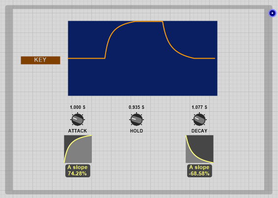

Re: Specific envelope needed!
Phew that took a while, but I made a version for you where you can change the attack and decay curves however you want, you can drag the curve graphics (taken from Trogs Tools, thanks Trog!). They can go positive or negative. Unfortunately I have only been using the FS Alpha versions for years now so you have to open it with the alpha. All the code is in assembler, optimized to max, enjoy!
env for Tom curve adamszabo (Alpha 2643).fsm- (47.78 KiB) Downloaded 1409 times
