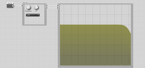

Postby KG_is_back » Wed Mar 26, 2014 5:49 pm
here's screenshot
KG_is_back

Postby tor » Wed Mar 26, 2014 5:56 pm
i see that, but what happens to the yellow curve when you change filter type to BP or HP?
*Edit: Here with me your second fix shows that the yellow curve is warped and the disappear near 20khz and the grey curve just stays at LP filter type.
