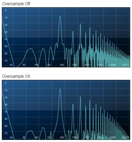

I used your oversample in my overdrive. Thanks KG !
- Oversample_Off_&_X8.JPG (42.3 KiB) Viewed 40444 times
