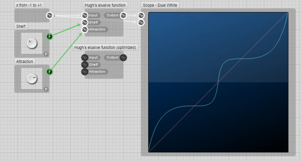

Postby martinvicanek » Sat Jan 07, 2023 4:36 pm
Hehe, that's indeed a very specific requirement. Here is my proposal (although, like Spogg, I have no clue what it possibly could be good for :?: ).
Hugh's elusive function.fsm
(14.45 KiB) Downloaded 946 times
Re: Elusive function
Postby HughBanton » Sat Jan 07, 2023 5:14 pm
OMG!! :ugeek: That is perfection Martin :ugeek:
I did make a start myself this morning with some DSP (honest!), got a quarter of it looking something like, but I guarantee I could spend a month on it and never get it this good (bitmasks and all) nor as streamlined. Thank you .. yet again.
