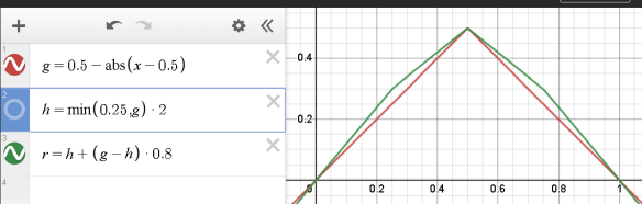

Also i find that it become an art at this point to design the best compromise or approximation..
With this approximation inverse and refrac technic we have to:
-First choose some truncated/windowed sinc coefficient.. Not sure i choose the best one...
- then if adjusting the refrac value, we could get better result for frac 0.25 or 0.75..
> Avoiding more frequency lost but at the risk to get frequency boost at other frac value..
So i let 2 bias control..
Refrac being just this image :

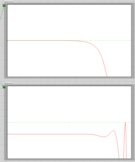

Now i find that it could be good to plot the magnitude error..
Sometime the fir would have ripple, we end up with little attenuation that affect more bass..
Here i multiply the deviation from 1 of the output level by 128.
The 8 tap fir seams ok but the 16 tap i'm trying to do attenuate bass which could begin audible at high feedback..
So it's about finding the best windows for a sinc function which is not so easy..
Here the 8 tap then my bad 16 tap coefficient :

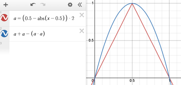

And now a 24 tap Fir Delay !)
I pass on 16.. Having trouble to get something better than 8..
Then i discover that the inverse coefficient are no more good when going to more tap.
(No more left = 0.75 and right = 0.25 when frac is 0.25...)
So now it's just a simple refrac value that blend the sinc coefficient with the linear one.
Like in the image.
They might exist other way and more precise way to do..
But this one seams a good ratio of precision/cpu.
