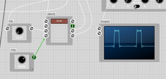

Does PW/PWM with the saw wave. PWM (with PW at 50%) on the 'SAW 2' wave sounds very Hammond / Leslie-like

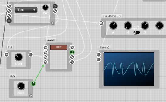

Testing the FM is simple. In the screenshot you see an amp marked FM; it's input is just connected to the output of a sine oscillator. The SQ osc sine is at wave index #2

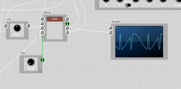

Thanks all for gnawing at this - can't follow the discussion as it's far above my head, but here's the little test schem using the Razorblade osc.
It's interesting that the deep spikes with FM only occur when taking the output from the osc directly. If taken from the output of the stream subtract used to do the PW with a pair of osc, the spikes are gone, but the FM forms flat spots that FM with regular sine oscs doesn't have.
