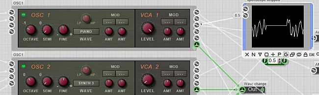

I kept hearing an odd couple of notes jump out with the PIANO wave, so I checked on a scope and found that for just a couple of notes around the middle of the keyboard, the wave has a considerable gap (flat line) in the waveform, that is very audible as a bright zing in the sound. I checked SQ8L and it's not there.

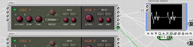

Also found it in the STRING wave, but for that, the flat spot is only not there for about the top octave.

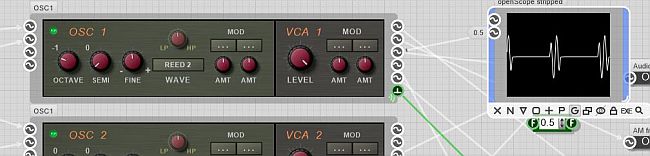

Considerable flat spots in REED2, but that's probably an additive wave and they're supposed to be there.
But PIANO and STRING clearly have something going on. I fear there's a ghost somewhere in the DSP.

Also found it in the STRING wave, but for that the flat spot is only not there for about the top octave.

But PIANO and STRING clearly have something going on. I fear there's a ghost somewhere in the DSP.![]()
My part of the work was to get the waveforms from the original rom and separate them into .wav files. We took all care needed to make sure that start and end points of the waveforms were correct, and that was not as easy as it may sound. Once we "cracked the code", so to speak, and figured out how the waveforms were put together one after the other and still be distinguishable [this is a word I always have to look up for spelling, I fear this word], it was easy then. We had to correct a few, where the markers were mixed with actual sample data, but we tested all of them in the end.
That's why I think, that something must have gone rogue, while you experimented with them. I'm not the expert for that part - all the really difficult sound engine parts were done by Spogg - , but I think there's a ramp or counter or something involved, that Spogg uses, and maybe the length there got mixed up somehow?

Each multi-wav “wave” has custom DSP code to tell the wav reader the sample size according to which wav is indexed in the wav array. I called that index the “Tag”. Turns out I’d made mistakes in the Piano and String DSPs, giving 512 instead of 1024 for example.
In fact the Reed2 was fine and you can tell because the waveform is never flat.
When I was testing the Piano, I found the transition from B6 to C7 (top of the 5-octave keyboard with C4 being middle C) was truly dreadful. It changed from a nice high note to a vile sawtooth with aliasing. So I checked the original spreadsheet we used and that was correct, according the table. It could well be a mistake when the table was created, so I took the liberty of changing from a nasty sawtooth to a much more pleasant “more aggressive sine.wav” and to my ears the transition is much improved, to the point where it sounds almost continuous.

I totally forgot I had that SQ8L plugin so I checked the high Piano notes using a scope and they weren’t using the aliasing sawtooth wav. Digging deeper I realised I’d originally not loaded the SAW2 wav but the raw sawtooth one, intended for the lowest pitches.
In fact the “more aggressive sine.wav” sounds just as good to my ears so I’m inclined to leave it in place.
