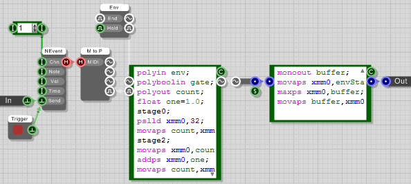

Postby Drnkhobo » Tue Apr 30, 2013 8:37 pm
Alright then. . . lets get things started shall we. . .
First up is the "Get Buffer" module:
From what I gather you create a midi note that triggers the buffer length? :?:
Via an envelope & some ASM voodoo. . ?
Is this something Ruby can handle for us now?
