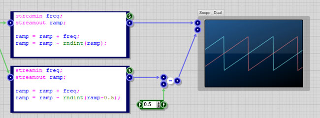

Im sorry but this is all nonsense. The sound of a synth or an effect has nothing to with with multiplication or division. Its how well your filter or oscillator or whatever is coded. Lets say that the maximum volume is 1. You want to lower the volume of the oscillator, so you multiply it by 0.5. Then the output will be 0.5. Now if you divide by 2, you also get 0.5. So what you are saying that the the first 0.5 sounds better than the other 0.5...It makes no sense.

Postby MichaelBenjamin » Mon Nov 05, 2018 10:28 am

Postby adamszabo » Mon Nov 05, 2018 11:24 am
Umm....no?
If you have a ramp that goes from -0.5 to 0.5 and 0 to 1 then subtract 0.5, you just push the phase of it by half a cycle. There is no difference in sound quality, like the OP says.
