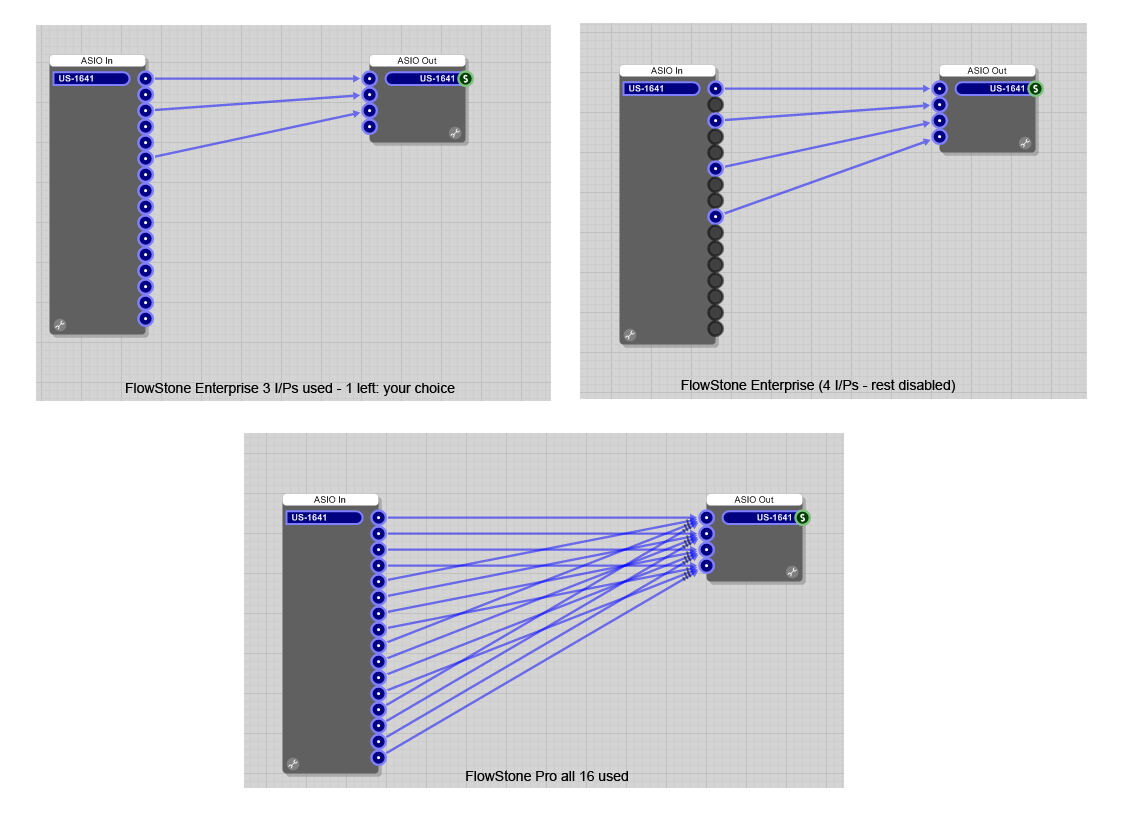

A good example of how the ASIO limitations work is to look at a multi channel audio interface like the Tascam US-1641. This has 16 inputs @ 96Khz, in FlowStone Enterprise only 4 will be available at any one time, in FlowStone PRO all 16 are available.
ASIO in FSE explained:
ASIO FES.png (91.23 KiB) Viewed 24783 times
DSP

Postby hologenicman » Sat Jan 29, 2011 5:23 am
That Absolutely clears that up!
Thank you.
I've been working with ASIO4ALL to set up a multi-mic ASIO device. So far, I have had compatibillity issues with my hardware, but I will keep plugging away at it.
Perhaps I will instead go with a TASCAM device since it seems to be ever so much more varsatile than the USB mics.
