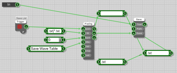

- Inside the save mod - This is from another OSM that seems to save but it's for the single sample instance of the OSM which has a different setup.

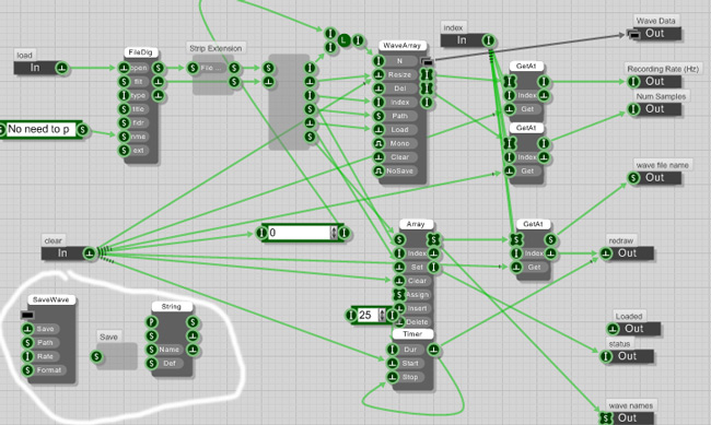

- Inside the standard WaveLoader that comes in the multi-sampler - notice my little save mod on the bottom. No clue where or how it's supposed to be configured or if it should be one level up?
- multi-save1.jpg (99.62 KiB) Viewed 37292 times

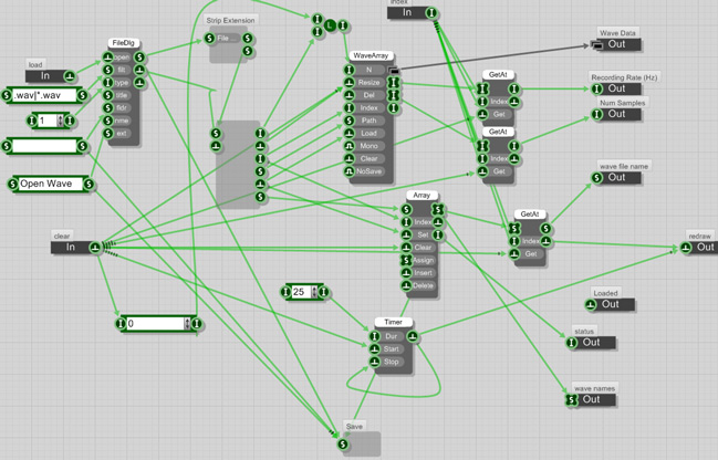

I've made a quick OSM file with a preset manager and all three variations of modules I've tried (shown on the bottom of the jpg attached too) various combinations with - if anyone would be kind enough to tie this together it would be greatly appreciated and I'll show a token of my appreciation to your paypal and hopefully others will benefit from this.
Fingers crossed and thank you in advance!

- multi-save3.jpg (98.66 KiB) Viewed 37269 times
SaveWaveMultiSample.osm- Standard multisampler from exo with preset manager and modules ready to 'save' wave file location - bottom three mods are the things I've tried playing with in many ways but no matter what I connect I don't get the desired result (found inside the wave loader within the player). Closest I've gotten is new samples being added to my existing ones that are IN the .dll but once I reopen a saved file in a host they are gone again.

Well, with a few modifications it's working in here. I used the string preset primitive to both save the path and trigger the sample loading. Formerly the sample loading was triggered by the dialog primitive - I have changed that so the dialog OK "sample and holds" the path that it outputs. That goes to the path/name separator and the path now goes to string preset. Output of string preset then puts the path to the part that loads the samples and also triggers it.
Try it on your machine if it works and let me know.
