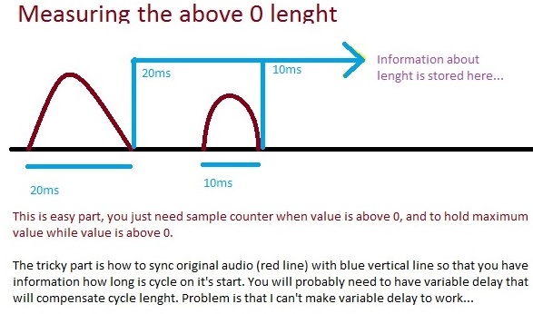

Look at the picture. I could post a FSM if you need it, but it is very messy...
Basically I want to calculate cycle length and to have that information right before cycle occurs, so I can set accurate release, independent for every cycle in envelope follower.
Logic is to:
audio -> fixed delay
audio -> sample counter -> variable delay(fixed delay - cycle length)
Logic is to:
- Cycle.jpg (62.8 KiB) Viewed 34514 times

As you suggest All you have to do, is to put constant delay on original audio. Detect the positive pulse length from the original (non-delayed) input. The event you want to happen should occur at constant delay minus detected length. That is the amount of time you need to delay the "side-chain" input, if you wish so. The delay will be modulated in a jump fashion but that shouldn't be a problem.

KG_is_back wrote:As you suggest All you have to do, is to put constant delay on original audio. Detect the positive pulse length from the original (non-delayed) input. The event you want to happen should occur at constant delay minus detected length. That is the amount of time you need to delay the "side-chain" input, if you wish so. The delay will be modulated in a jump fashion but that shouldn't be a problem.
Indeed, there where some bug in my schematics, but now it seams to work...
