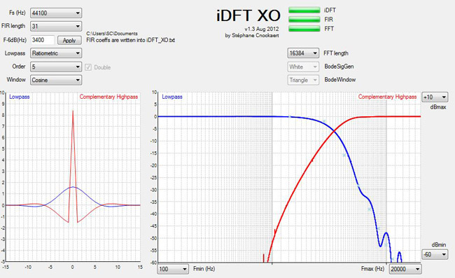

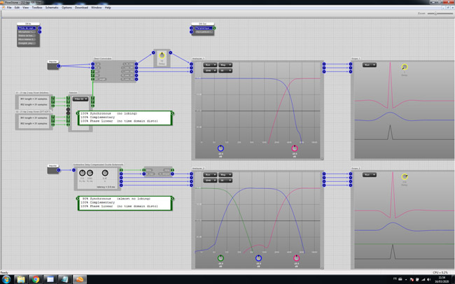

I wanted to implement a 31-tap FIR filter, as 2-way crossover operating at 3,400 Hz. I've designed the following .fsm, exploiting Martin Vicanek 32-tap Direct Convolution (DC) routine:
It is incorporating comparisons with other crossovers.
- I have compared with the subtractive delay-compensated crossover. For for such purpose, in order to provide a quasi 4th-order highpass slope, I've selected a double 2nd-order Butterworth lowpass filter (similar to the lowpass branch of a 4th-order Linkwitz-Riley) whose delay gets sightly overcompensated on purpose. John Kreskovsky presented such trick in his "A New High Slope, Linear Phase Crossover Using the Subtractive Delayed Approach" technical note dating back from December 2002, that he revised in April 2005. Unfortunately, all the graphs John Kreskovsky published, were formatted for keeping us unaware of the non-monotonic behavior below -35 dB. Moreover, unfortunately, John Kreskovsky did not warned about the delay sensitivity & granularity issue. Such effect shows when crossing above 2,000 Hz when Fs = 44.1 kHz. When crossing at 3,400 Hz, you shall hesitate between a delay of 5 samples, 6 samples, or 7 samples. We are talking about integer numbers. You need to obey the discrete steps. There is no question of "fine tuning" the delay, thus. Kind of fatal deception would you say. No possibility of fine tuning the delay would you say. Wrong! You still can do a fine tuning, by choosing a 6 samples delay, and fine tuning the crossover frequency around 3,400 Hz using the 32-bit floating point precision of the x86 SSE. Or using the 24-bit fixed point precision of the DSP56K. It is that simple. Kind of Columbus egg. Now comes the truth. Continue reading because there is a miracle occurring. When you base on a on a lowpass filter that's a double 2nd-order Butterworth (instead of the 3rd-order Butterworth lowpass Lipshitz-Vanderkooy are suggesting in their 1981 publication at the AES), and when you slightly oversize the compensating delay (or tweak the crossover frequency for a given delay), the lowpass and highpass slopes are both becoming quasi 4th-order slopes in the transition band till -30 dB. This is a miracle because in 1981, in their 51 pages communication to the AES, Lipshitz-Vanderkooy are taking 20 pages full of math, for telling that the quasi 3rd-order highpass slope they are attaining with their subtractive delay-compensated scheme, is the max highpass selectivity one can expect, whatever the order of the lowpass filter. After having seen such miracle, you may think that the show is ending here. Not at all. There is a second miracle. Indeed, when you base on such double 2nd-order Butterworth lowpass filter, the relative phase mismatch between the lowpass output and the higpass output, in the transition band, is approx. 30 degree or so. Thus, such subtractive delay-compensated crossover is now quasi-synchronous. Consequently, such crossover is indeed a) quasi 4th-order, b) symmetrical, c) quasi-synchronous, and d) transient perfect. In other words, such crossover is very close to perfection, so close to perfection that there is no need for a 32-tap FIR filter acting as crossover, when crossing above 2,000 Hz. Such subtractive delay-compensated crossover is requiring little computation power as there are only two IIR Biquads to compute per lowpass / highpass pair, plus one delay, plus one subtraction. John Kreskovsky was right. The slightly over-compensated delay subtracting scheme that's applied on a double 2nd-order Butterworth lowpass filter is probably the best scheme one can imagine, and it is requiring no more computational power than a plain normal 4th-order Linkwitz-Riley. Unfortunately, below -35 dB, the attenuation curves appear to be non-monotonic. Which means that in case one is not publishing the global phases curves, and not publishing the transient responses, and only publishing the attenuation curves on a 100 dB scale, the Linkwitz-Riley crossover appears as perfect, and the slightly over-compensated delay subtracting crossover that's applied on a double 2nd-order Butterworth lowpass filter, appears as zero-value crap. Now is time to find a better name for such crossover I am advocating for, like John Kreskowsky did long before me. It should be named SOCDS-DB2. Slightly Over Compensated Delay Substracting - Double Butterwoth 2nd-order. All digital crossovers should be SOCDS-DB2. The attached .fsm shows how to implement a 3-way SOCDS-DB2 crossover crossing at 170 Hz and 3,400 Hz. Its propagation time is 2.8 ms. In case of crossing at 85 Hz instead of 170 Hz for targeting a subwoofer + 13 cm woofer + tweeter combination, the propagation time is approx 5.0 ms. Nothing to worry, thus. Later on I will show how the natural unfiltered 2nd-order lowpass slope of a two-chamber 4th-order vented subwoofer can get 2nd-order lowpass filtered, for emulating the 4th-order lowpass transfer function the SOCDS-DB2 environment is requiring.
What I am telling, is for a 3,400 Hz crossover.

- I have compared the SOCDS-DB2 solution against the Linkwitz-Riley solution. The frequency domain responses are essentially the same. The time-domain responses are fundamentally different, in favor of the SOCDS-DB2 solution, quasi transient-perfect.
Imagine now, dealing with a 340 Hz crossover.
The SOCDS-DB2 crossover will perform just as usual, requiring little computing power.
What about a 32-tap FIR filter crossover, crossing ar 340 Hz?
No way! A 320-tap FIR filter is now required. Quite expensive!
Consequently, the SOCDS-DB2 remains the only practical, quasi-perfect & affordable solution for building a near-perfect 3-way crossover.

I am now attaching the iDFT XO Visual Basic application I wrote in August 2012 for calculating FIR filter coefficients (weights) in the context of 2-way phase-linear synchronous complementary (ideal) crossovers.
One can rely on Flowstone Ruby for generating a .fsm that's doing the exact same.
I am attaching iDFT XO souce code:
Use Notepad ++ for navigating into iDFT XO source code.
Notepad ++ can be downloaded here:
https://notepad-plus-plus.org/downloads/
Have a nice day
