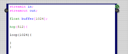

It seems to me that one cannot do loop() inside hop(). See the picture. ... I am using FlowStone 3.0.6.
it cannot loop execution?

You can only do it in the assembler

Thanks for the information. I have not yet studied assembler language, though.

Sorry, I did not check MV's updated loop tutorial in which the topic of "nested hops ans loops" was well instructed. thanks!
http://www.dsprobotics.com/support/viewtopic.php?f=2&t=43224
