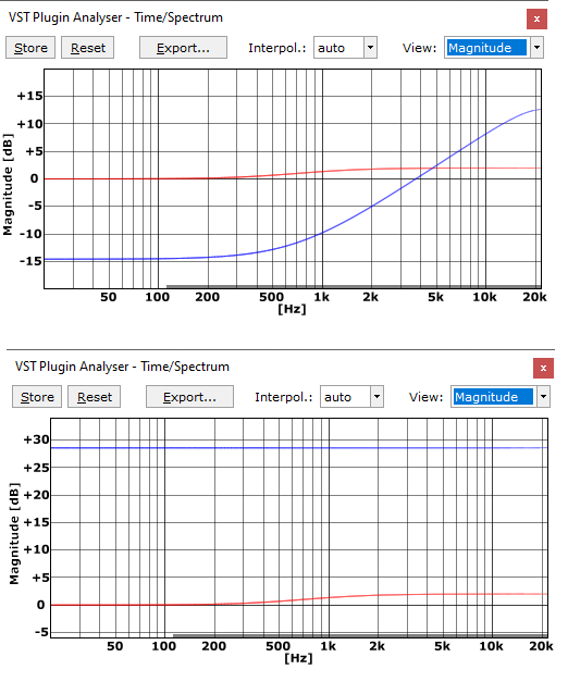

1st order LPF implementation schematic can be found from here does not give correct response when exported to VST (VST Analyzer software). What I get are these responses:
(lower response after normalizing a0=1)
(NOTE: red curve is for high shelf filter )

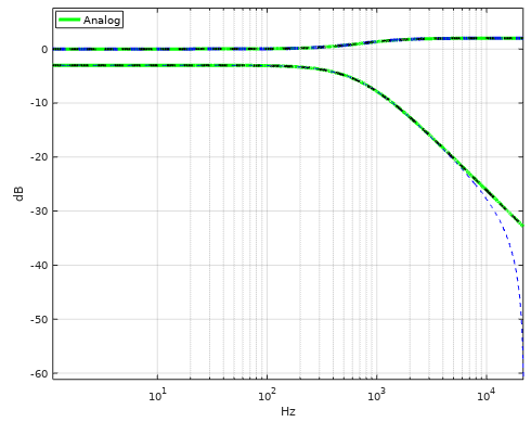

Filter is designed using Octave:

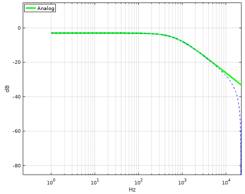

and it gives this response in Octave (and in all other software I've tested so far):
(green = target response, blue thin -- = BLT version, Earlevel plot https://i.postimg.cc/j27DLqVg/earlevel-LPF1.png)
In comparison, 1st order high shelf filter implementation there in plot and schematic gives same response on both software.
Any suggestions on possible culprits for the issue?

Hmm... I think it's OK that way (I don't have access to schematic ATM so I can't check if all coefficients are divided by a20 there) ... meaning as a21 = a20 and you scale by a20 then a21 = 1 (i.e. a21=a20/a20) ... actually, this can be checked with attached Octave listing as well if you scale by b(1) there it results following coefficients:
which are OK as seen in plot: https://i.postimg.cc/4NhvmXwC/lpf-earlevel.png
a = [ 1 1 ]
b= [ 29.7506663062669 -26.9222391815198 ]

The instruction a21 = a20/a20 looked weird to me, but if a21 = 1 is correct then you have a pole at z = -1. That means your filter rings with Nyquist frequency forever! For a stable filter all poles must lie inside the unit circle on the z-plane. Maybe you have the a and b coefficients interchanged?
Re: LPF doesn't work as supposed
Thanks,
probably it's related to what you suggest because of I can replicate that mirrored response (showing in my 1st post image) by swapping a and b... but, IIRC, I tried swapping coefficients earlier in FS code and the result was not OK in VST analyzer (actually no response at all (checked from -3000dB...3000dB range) so maybe it resulted a blown filter then). (NOTE: I'm running FS on 64-bit W10 ... and also VST Analyzer is an old 32-bit software now running in same PC so maybe something is not fully trusty anymore...).
So, I'll have to re-try by swapping the coefficients in FS ... .

OK, got the LPF working by swapping coefficients as MV suggested.
