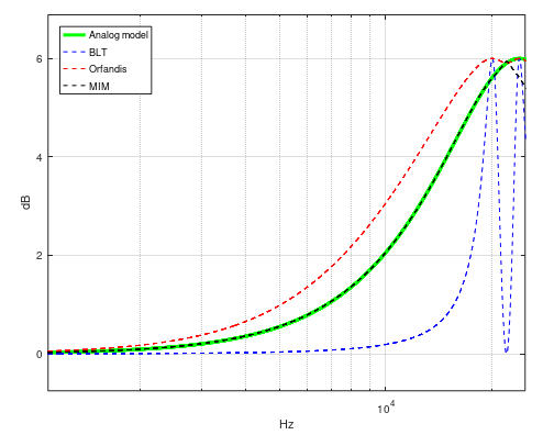

Dunno if you can do this well ... though, MIM method works in this well even without up-/down sampling.
