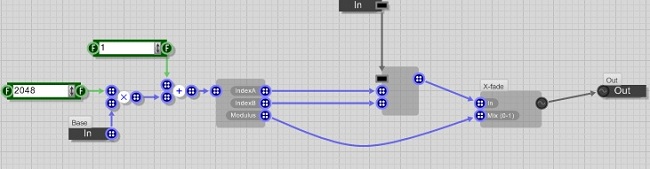

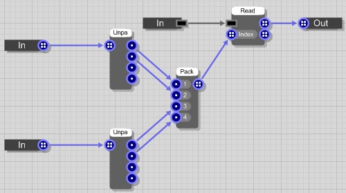

That readout module is a simple linear interpolation table lookup module.
This is the old (pre SSE2) way of flooring an sse register. It floors the 4 floats seperately on the x87 float stack.
This is inefficient. Today you would just do
The code looks like it comes completely unaltered from the output of a DSPCode Module.
The unpack-pack business should better be done with shufps instructions.
It's done to get the value in the table at IndexA into the lower 2 floats and the value at IndexB(which is just IndexA + 1) into the upper two floats.

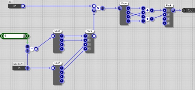

Then the linear interpolation between the values is done in the X-fade module.

Ok let me see if i got it right, if that means just rounding to int basically we have to this in read out:
I'm guessing 'wave read' prim does something like index=max(input_index, array_size) so we also need a max(base,1) at the beginning.
IndexA = RoundToInt[(Base*2048+1)-0.5];
IndexB = IndexA+1;
Modulu = Base - IndexA;
Readout = ArrayFromTransfer[Index a] * (1-Modulu) + ArrayFromTransfer[Index b] * Modulu

Re: Need some help with this Code
Yes that's almost correct. Just a small mistake.
I think you mean index=min(input_index, array_size - 1) and min(base, 1.0).
However, even if you clamp base to be less or equal to 1.0 the highest index that the code tries to access would still be 2048 + 1 + 1 (=2050).
I'm not sure what the point of the "+ 1" in "Base*2048+1" is to be honest.
temp = (Base*2048+1)
IndexA = RoundToInt[temp-0.5];
IndexB = IndexA+1;
Modulu = temp - IndexA;
Readout = ArrayFromTransfer[IndexA] * (1-Modulu) + ArrayFromTransfer[IndexB] * Modulu
