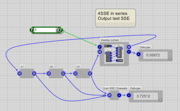

Re: Sweat the assets using SSE
Hum ...
Just after i made all of those module, i discover that it's more smart to use the first one,
and to place simply the code in series like this :
- Series more smart.png (36.14 KiB) Viewed 18009 times
