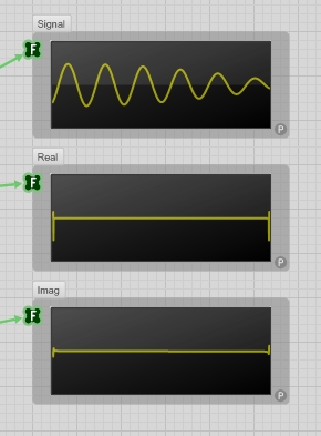

Hi, all.
On the picture example of work of FFT. Whether it is possible to get access to every period of a signal separately? May be convolution?
Sorry, I bad speak english.

Lex, we need more information.
What do you mean by "access to every period of a signal separately"?
Do you want to take the Fourier Transform of one period?
Why would you want to do that?
What is the context?

Postby Lex248 » Wed Sep 20, 2017 9:30 am
For example, I want to make so through FFT, but standard methods don't allow to make so.

Postby martinvicanek » Thu Sep 21, 2017 7:04 pm
If the signal is as simple as in your picture, then you just need to check for zero crossings to determine the period.
It is still not obvious to me why you would need a Fourier transform to zero out one signal period. :?:

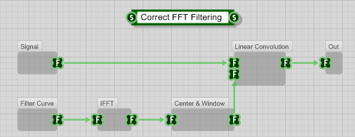

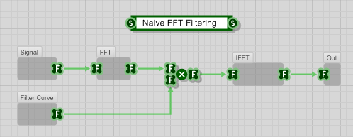

Postby martinvicanek » Fri Sep 22, 2017 11:40 pm
People tend to think of an FFT representation in terms of a graphic equalizer, where you can simply multiply each bin by its corresponding slider value, then simply inverse FFT the result and that's it:
That might work if your filter curve is very moderate.
However, the correct way of doing it is based on linear convolution.:
You first IFFT your filter curve to obtain an impulse response (IR). Theen you apply a circular shift so the bulk of the IR is at the center of your frame, and apply a window function to avaid border artifacts. Then you convolve your signal with the windowed IR.

Postby martinvicanek » Sat Sep 23, 2017 11:42 am
No problem, just keep updating your IR as you go. Use overlapp and add to avoid sudden changes.
