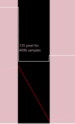

Careful! By comparing it through a scope, you fall to a trap.
The scope only display a few pixels, not nearly all incoming samples. Imagine it like a hop as well. In reality the line will either not look that linear, although better than the staircase, or the dsp module IS calculating each sample instead of only each 4096th.
Also, your code ignores discontinuities. The saw wave would start at -1, after having reached +1. So the two samples at that position would read +1, -1
Your code introduces a delay of 4096 samples, before -1 is reached after +1
Not sure, if these are important points, but they are for sure existing, and I don't think they should be ignored
