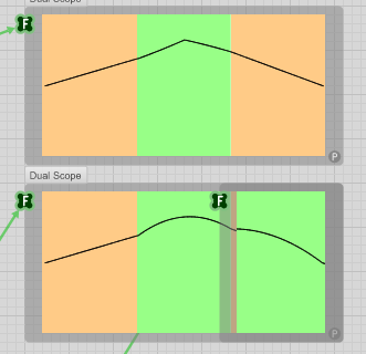

I was not hearing it. But the interpolation was not very good.
Doing an angle at the center...
Sorry, now i could see more clearly what it does with an array.
I make another one that's very similar and low cpu, but now there's angles at the edges...
interpolation test.fsm- (6.31 KiB) Downloaded 739 times

I make a better tool to evaluate the interpolation.
Evaluating more sample to see the continuity.
The second interpolated solution with a mod is a little better.
But with sharp angle, or in some situation, it need improvement.
I will loose some time to find my own solution.)..
But i'm almost sure that copying a cubic interpolation would do better with not so much more calculation..

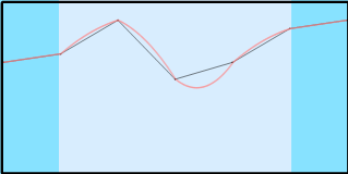

As intended, i tried some formula, but none was better than a cubic interpolation.
But even with this one i'm not completely satisfied with the behavior in some situation.
(even if others are perfect)
Here in red the result of the cubic one. But i want something like the green that i do by hand.
Do you know a way to do so ?
I find here the cubic interpolation : http://paulbourke.net/miscellaneous/interpolation/
(i just try and add the Hermite, but it only attenuate the bounce)
