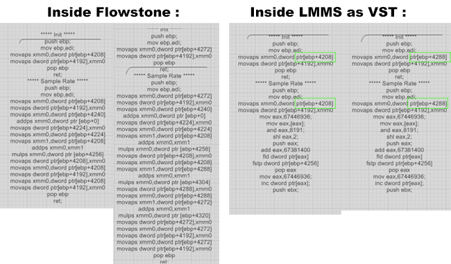

I try some test with the analyzer prim..
But i'm not sure what to think about it !)...
In Flowstone the analyzer always show 2 same code when we switch.
It will use the same variable number.
Seams an indication that the code is a memory that is switched and not recompiled, but not a proof at all,
and it's not the same in a vst..
As a vst in LMMS, i have to play some note before i could read some code change.
But the code is not complete. It seams that it point somewhere in a different place when the code is switched.
... So i don't know what to think...

Yes it's very difficult to know.
I will maybe do test later with bigger code.
What surprise me the most is the instruction "mov eax,[eax]"
What could do this ??)
In the end there's also a push ebx. But ebx is not used..
A lot of mystery !)
Reading some other topic of the forum i also notice that the stage 0 if it exist will be executed each time the code is reactivated.
A lot of mystery !)
