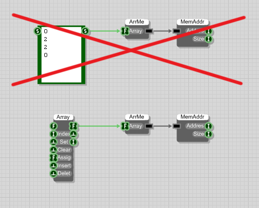

No more crash for now, but i'm a little paranoid after getting so much..
My big error i suppose was to use the text prim to the array to mem.
In my version 3.6 it almost always crash on load, even if i disconnect the text.
With an array prim it's ok.
