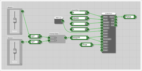

In this example we show how to communicate with the Robot Electronics MD25 motor controller. We used the RD02 drive system that uses a MD25 controller.
Robot Electronics MD25 clip.png (68.5 KiB) Viewed 49879 times
