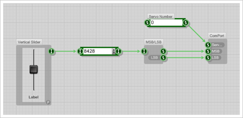

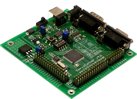

In this example we control a single servo (S0) on the Yost Engineering Servo Center board.
In this case we are using the USB virtual Comport driver supplied with the board. We have set up the Com port to be Com 8.
There are two ways of communicating with the Servo Center via ASCII or Via HEX so we have made two example one for each.
